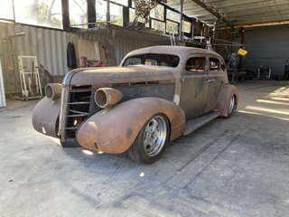

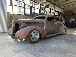

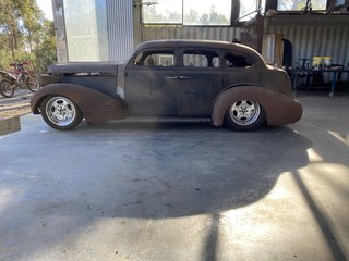

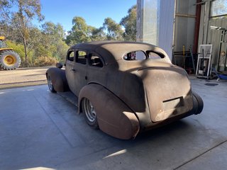

Re: 1937 Pontiac sedan build
Looks really cool like that.
What you need to do for posting the images as above, is click on the image once loaded so there is the only image showing, then right click the image and select 'copy image address'
Come back to the post you have started and select the image icon that has the mountains and sun in it. It will place, or you can type,
There might be a shorter way but I just tried that way for the first time and it worked.
Thanks Gojeep, yeah it’s a great shape and era for automotive design with spill overs from the art deco period. I plan to leave the body in as is condition, haven’t decided totally on what the exact finish/seal will be. This’ll become more clear towards the end of the build.
Also I’ll give your upload tip a crack next time for sure, cheers.
