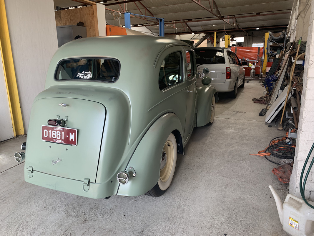

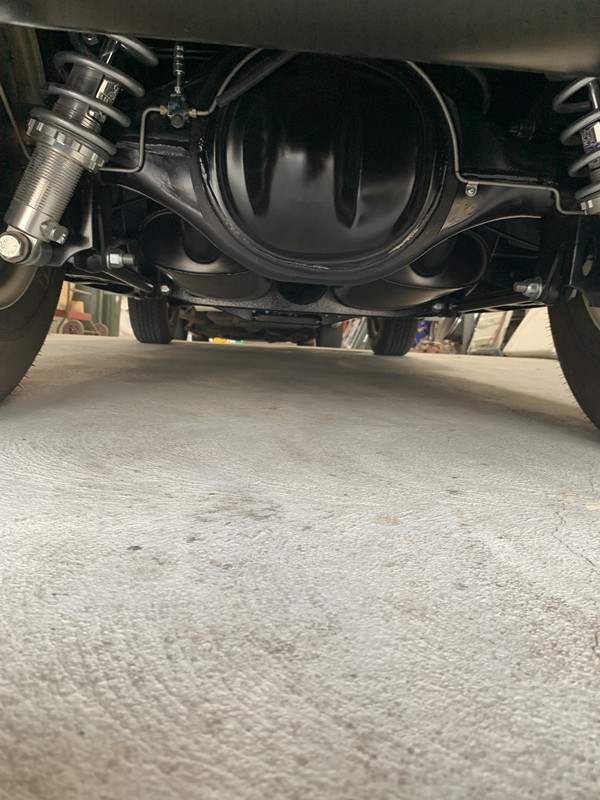

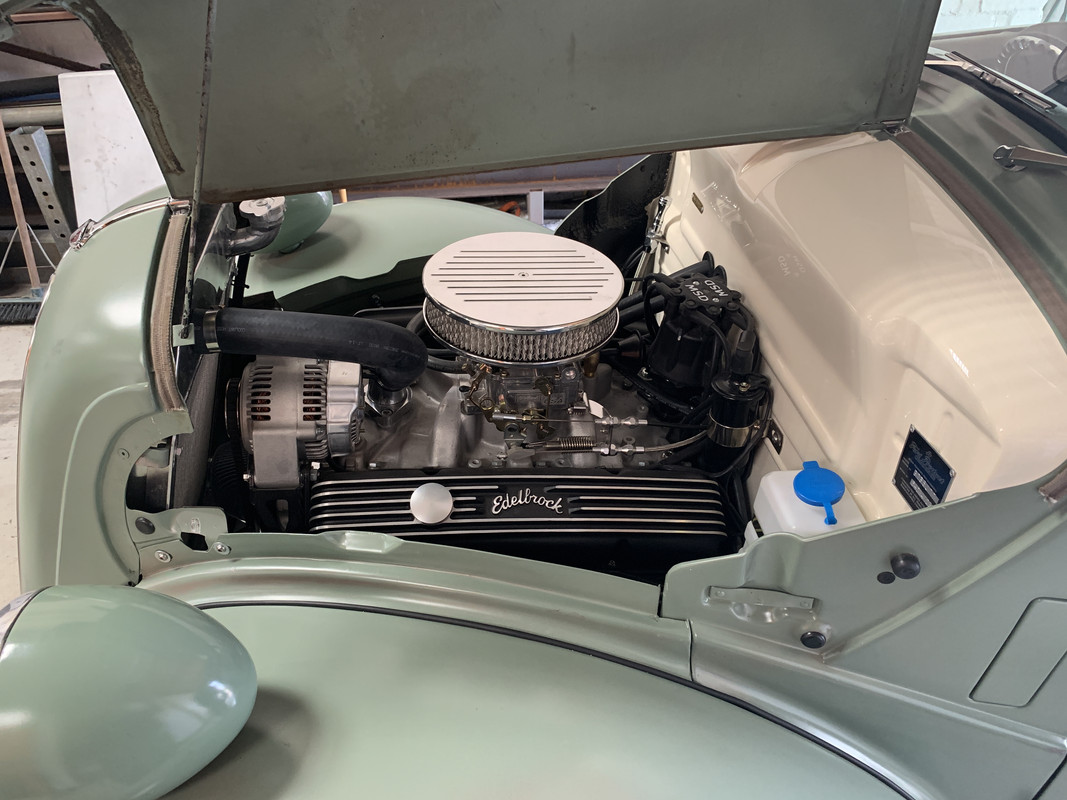

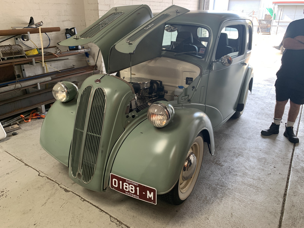

That looks like an interesting project, I built an 1950 Anglia a few years ago for a customer, stock bodied, 350 chev, turbo 700 trans, shortened 9" diff, handmade independent front end, Here's a link to the build, some photobucket photos have disappeared and the rest have water marks on them, it might give you some inspiration with your build, I have all photos if you want any
viewtopic.php?t=59700&hilit=toprodz+anglia&start=150
Here are a couple of photos of it all finished
All I can say is, build the car you want, don't be put off by the Naysayers, so many people have told me that things can't be done, probably because they have never tried, anything is possible,
Good luck with your build
