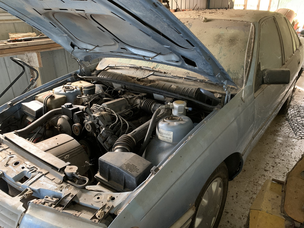

Re: "Boss" - EH Ute Build
Hi Hewey, it has its share of issues that can all be fixed but overall its fairly solid.
After a heap of research on what others have done to fix similar issues and the great availability of reproduction parts, it had to be saved and kept in the family.
It has to wait its turn, but I'm looking forward to the day I can hook into it.

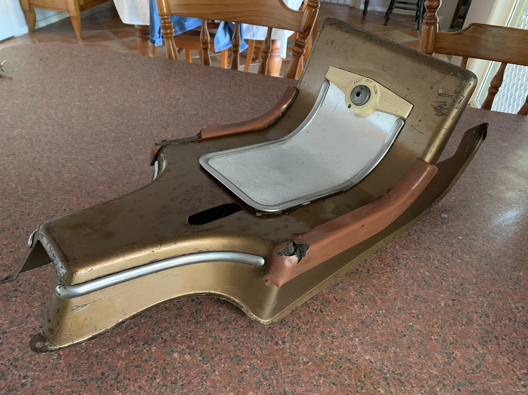

I saw this for sale in NZ about 18 months ago at a heaps cheaper price compared to what I had been seeing them advertised for so I agreed a sale and crossed my fingers that it would turn up.
Time was getting away and I was starting to think I’d done my dough, then to my relief it turned up.
Should clean up well when the time comes and add some character to the interior.

Nice shape to it. What was it out of?
- Posts: 1997
It's an original EH console, I'll need to fill the hole that someone cut into the top.
Nice score there Pete, it would have been out of a Premier I believe.

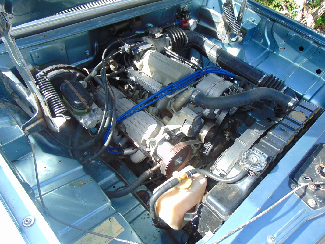

- Posts: 1997
Thanks for the info Frank, I’m with you on the look of the Ecotec engine compared to the look of the Series 2 VN, VP engines that I think work better with the age of the ute.
Over a year ago I purchased my late father in laws Aug 91 VN Commodore that he bought new and was always a country car and well serviced by Holden. The mother in law needed a new washing machine and wanted to sell the Commodore but hadn’t done anything about it so I paid $700 for the washing machine and I got the car, so everyone was happy.
It’s been parked up for quite a few years now, but I remember driving it and it pushed the Commodore along well. Unfortunately, it’s a manual so I’d need to get an auto box and I’d look to use the diff and wiring harness as well.
The V6 fills the engine bay nicely, an LS1 would be nice but combining two of the father in laws cars was the original plan and will give the car its DNA.
Here’s some in EH engine bays.

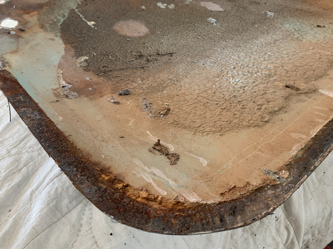

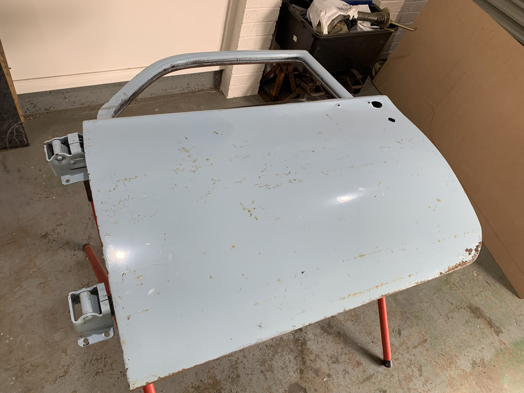

Managed to score a left hand door that was complete except for the glass for $50, how could I refuse.
I’ve decided to reskin both doors as part of the build to make sure they last and it turned out to be a good idea.
Lots of rust on the door skin, luckily the door survived a lot better than the skin.
