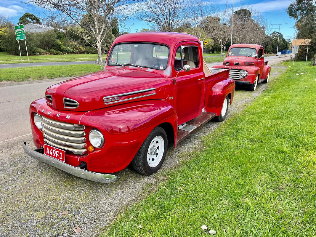

]I have an S111 6 cyl under the front of our 49F1 with 350 Chev. Sits nice and rides well, the lower arms have a slight downward angle as well, goes around corners with zip roll.
Mine is the front vehicle,stopped by the side of the road when I spotted the 50 model behind me. It also has a 350 and running the original beam axle f/e------------------------------------
