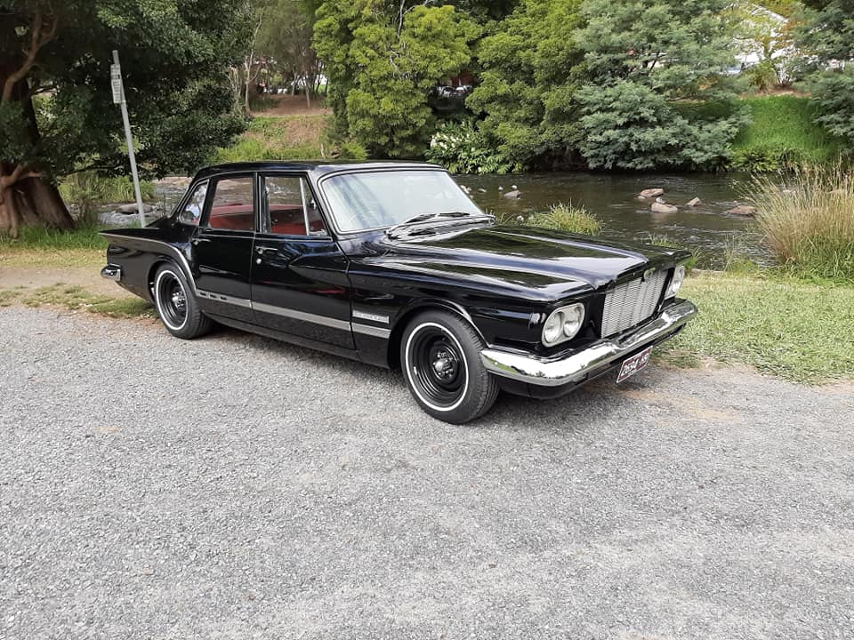

Still a few things to do as previously mentioned but spent the weekend cruising . We racked up about 350kms of trouble free driving , just a couple of tiny issues that need adjusting . Handles and drives great with plenty of power from the slant six . It certainly has come a long way from when we first took possession 3.5 years ago

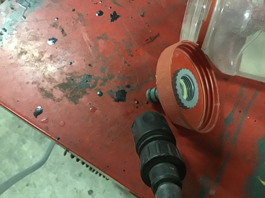

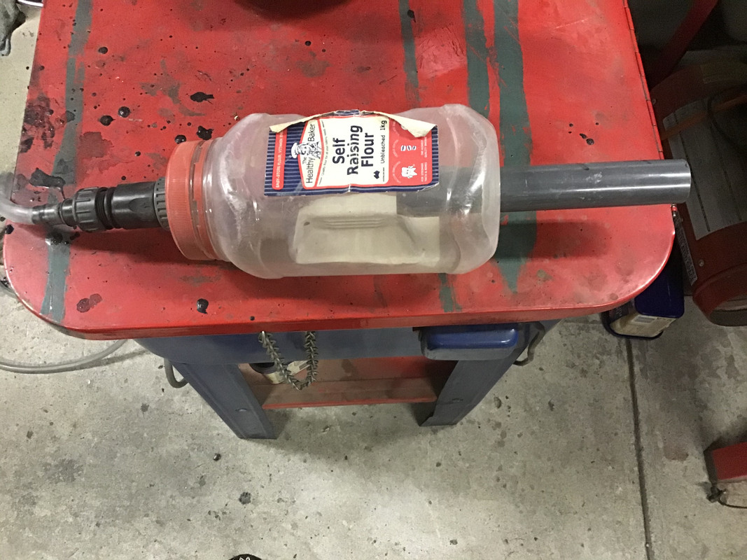

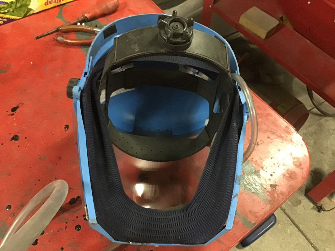

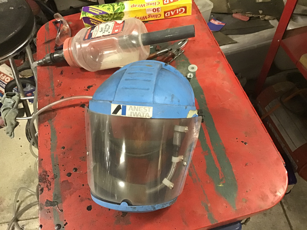

Back in June 2018 (just reading back through your posts as part of my Covid-19 isolation) you mention how you "set up my positive air breathing system with the mask I had bought from motorex". Can you tell me more about that please.

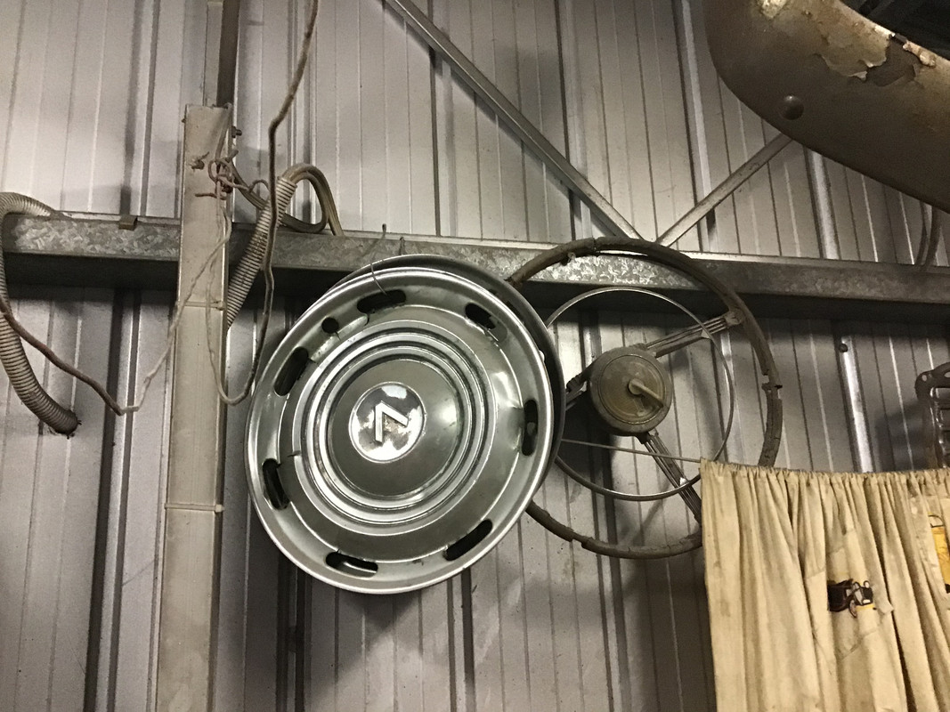

Did you keep the hubcaps?

Thanks again everyone for looking in and the positive comments, it is much appreciated. Robtus , everything I put together with things I had in the shed or got locally . Reversible vacuum cleaner came from the good guys Vacs brand from memory . Clear tubing and hose fittings from Bunnings, flour container from pantry and mask from MotorEx. Screwed the hose fitting into the screw lid of container and a tapered vac nozzle through a hole in the bottom of the container, which then fits onto the vac hose . Tubing gets a hose fitting on one end the other to the mask . As long as the vac is blowing air flows into the mask keeping fumes out . Container was used as the easiest way to downsize vac hose to mask tube
Mudgy , my old man always looks in my garage and says “ when are you going to throw some of this shit out “ , to which I reply it is my shit and it doesn’t cost anything to hang it on the wall , and who knows might use it one day
