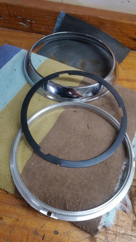

Hello OzRodders;

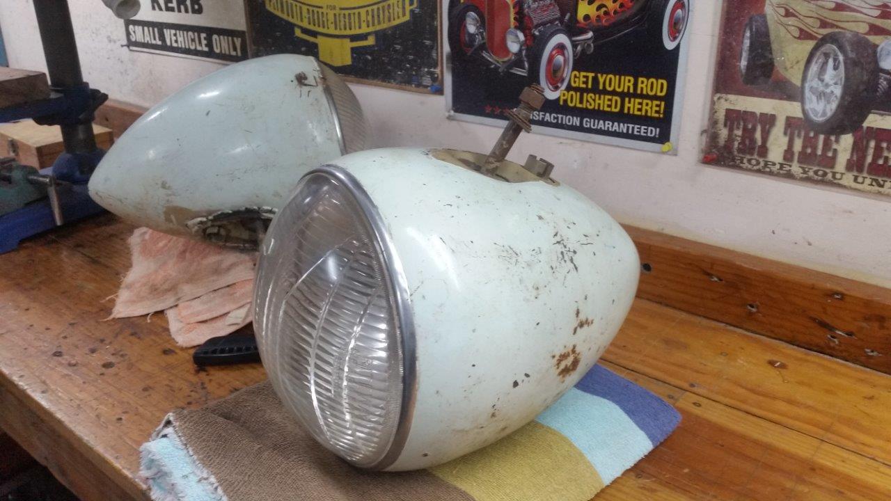

I received a pair of very nice headlights today from a fella In Adelaide (Thanks Tim)..
I took a look at the H4 conversion I did (with all I had at the time) and it turns out I really needed these S.A. lamp assemblies.
1. because they are MINT.... glass included, and all the innards are lke new..... these are the newest pieces I've ever scored for this car.
2. Because I can now use my Headwinds H4 adapter kit without having to modify ANYTHING. YAY.

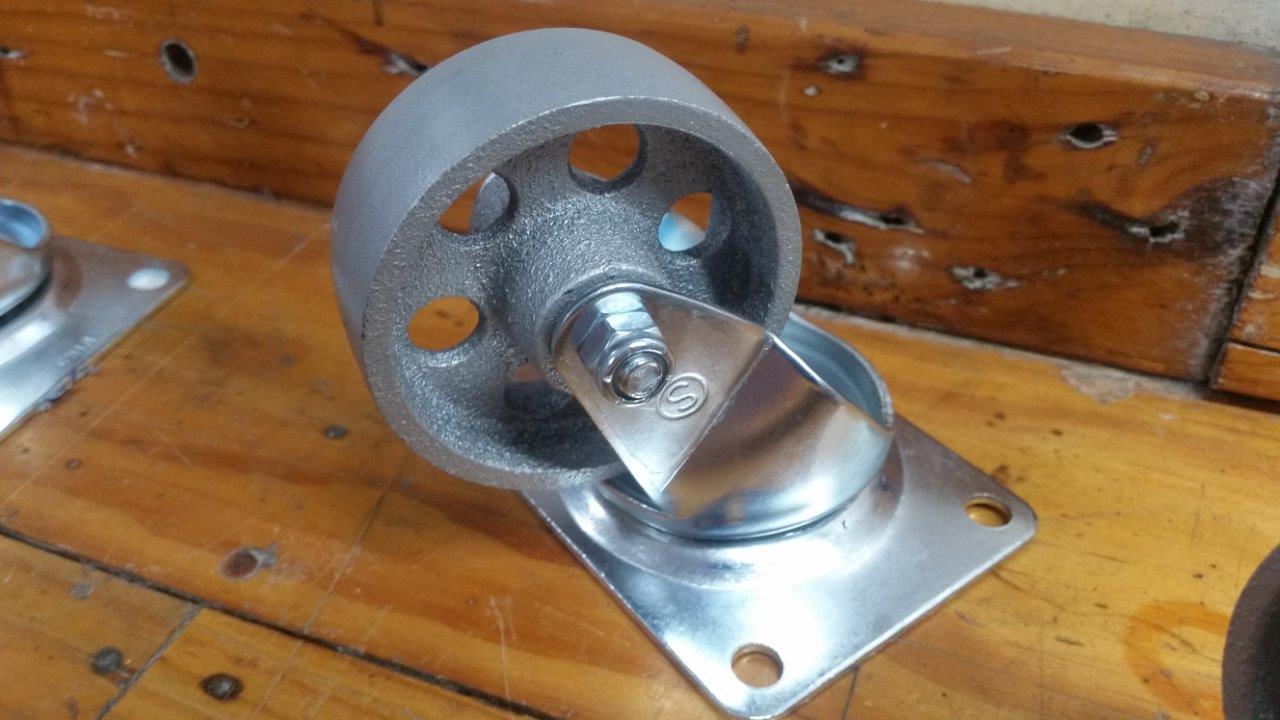

I also had to replace the castors on my body trolley today.. the old ones were stuffed. Cut 'em off, and welded on 4 x of these suckers..
Here's the lamps.
Don't need these brakets anymore...

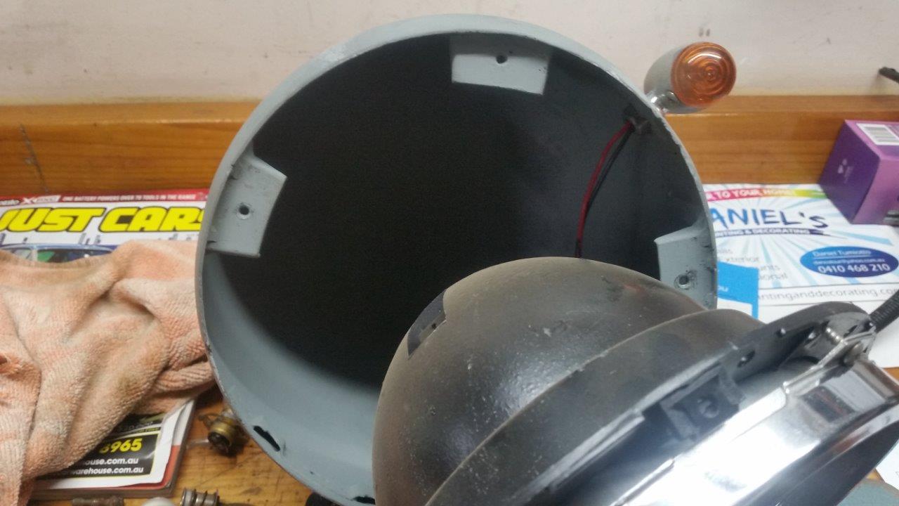

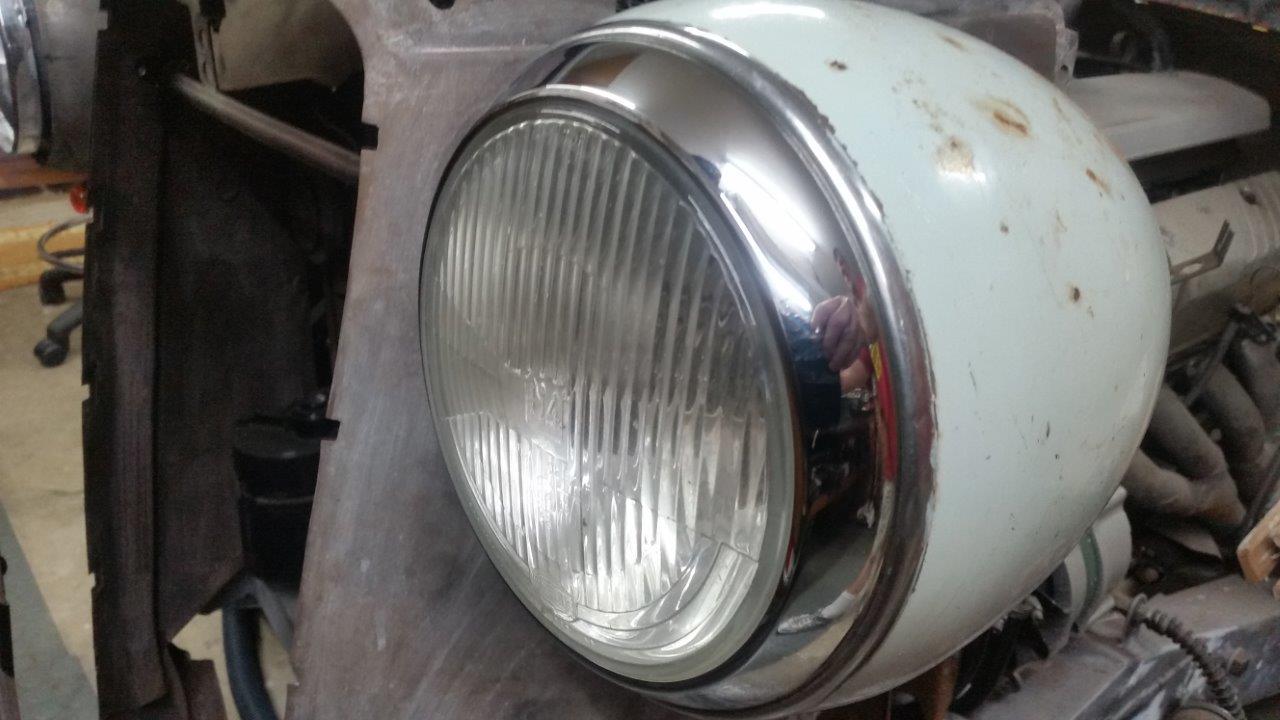

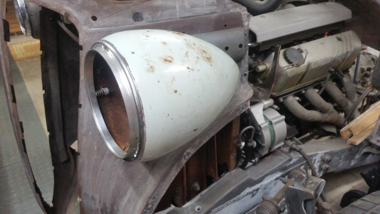

So, how it all works is - remove the original lens and reflector..... clip in the alloy backing ring with all the original hardware...
fit the H4 lamp to the steel plate/ring... then use the alloy bezel to "sponge fit" it all back in again... the alloy outer dress rings assume the profile of the old glass lenses. And by the way I have 2 x reflector assemblies and 2 x MINT lenses if anyone wants them. (stamped "export" so that means all the flutes in the glass lens means the "beams" will point to the left.
Thank God I left these alone while I could think of a way to attatch them.

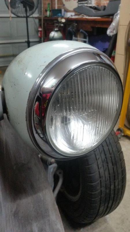

So the H4 assemblies just fit into the ring, and the new outer bezel just "pops in" like they were always meant to.
Here's a guy with a '37 Plymouth doing a light bulb replacement.... showed me "how to do it"
Hope this is of help to anyone with one of these cars.
Cheers, Mudgy
Here's the lamps.

I'm really chuffed I can use all the hardware that came with the bezels from the USA, and I don't have to dream up any tabs/mounts that could have stuffed up the chrome finish.
All I really needed was some Ridgey - Didgey light pods, and it all just works.
I'm putting in the bullet shaped indicators now, transferring them over from my first set. Looking OK so far.
