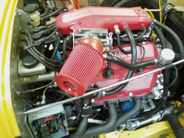

Air filter turned up the other day. It came from ebay, $50. Made in France by JR. The flange pipe is a real stretchy rubber material so I had no trouble making it fit over the alfa throttle body, 75 to 83 mm. And it colour matches just nicely.
