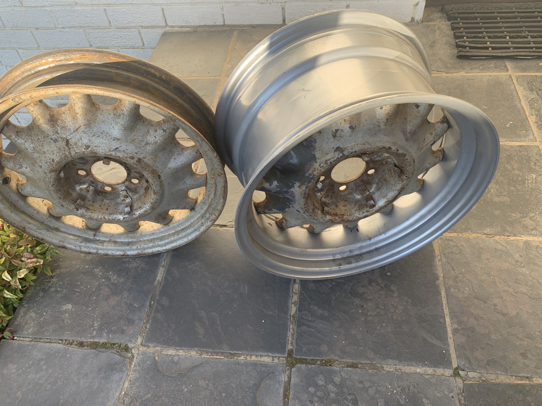

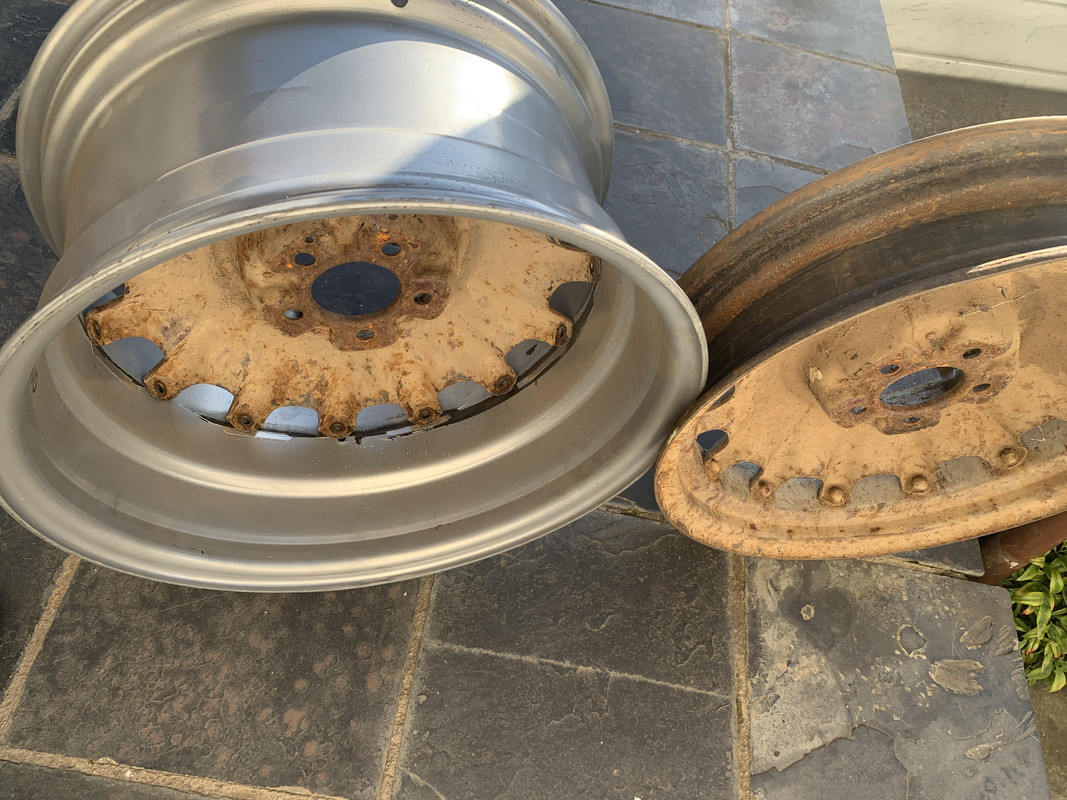

I recently found some 1936 Chev Artillery wheels, I have 4 coming from Queensland at some stage, I also found 6 locally in Melbourne, which I am informed that they are late 35 chev as they are slightly different to the 36 chev ones, The hub caps are held in with 5 spring clips whereas the later ones are held in with a ring on the inside of the rim that i believe the hub cap slips in between.
The good news is that the inside of the original hoops are 392mm which is the same size as the new aftermarket hoops, which are available in 4.5", 7", 8", 9" and 10", I picked up a used 9" bare hoop today, just need to find an appropriate tire size to suit, hopefully a 285/60 x 17" which are about 30.5" tall to try under the back guard of my Jailbar sometime soon.
Here are a couple of photos
This is the difference between the old and the new version
The center is just tapped in place with about a 6" back space at the moment, they will probably end up around 4.5" back space.
I am loving the look so far as I have been looking for some of these for around 5 years and am happy that the plan is coming together

Look really good in the wider rim.

They look great Pete, your patience has paid off.
With increased dish they will look even better.
