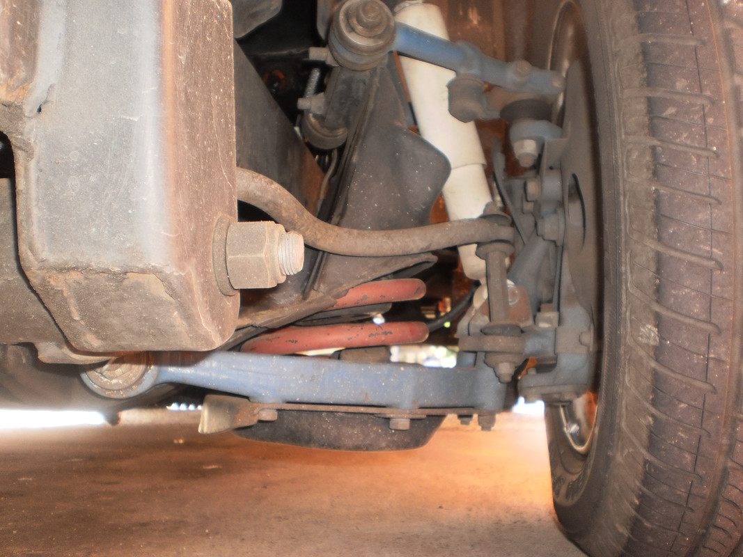

Frank , do you still have any of the plastic shims in with your springs ?
I pulled the 6 cyl springs out of mine and put the v12 springs in, but it raised it another 150mm , so they are coming back out .
I'll install the new 6 cyl springs i have , but this time will install the 2 shims per side that was originally in it that i had left out .

Re: XJS Jag fornt spring rates ????
Yeah Dave i'm getting real good at it .
I'm gunng put the new 6 cyl springs in with 3 plastic shims per side , from all i can find on the net it should lift the front about 1 inch .

Trying to remember the shims Scott, not knowing if in or not. Over the years when these vehicles were worked on anything can happen.

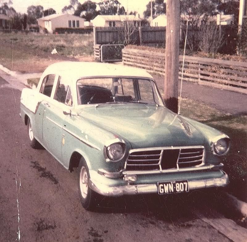

Those old valve radios. Vibrator power supplies to supply 150+ volts for the HT supply to anodes and huge current draw. The best came later. "Hybrid" using 12v direct operation valves with transistor audio stages. Warm up time was pretty quick. Those radios back then had greater sensitivity to pull in distant stations. Memories alright. looks like mid to later 58 plates. The grille looks neat, I had an FE and pulled the grille bars completely. The center was flat steel with punched diamond mesh from the hardware store. Painted it silver. Removed the over riders from both bumpers and trimmed the rear number plate surround to fit on the boot lid.
yes Frank my dad was into radios and TV,s he built a few tvs in 1955 before we got it in 56
we used to get test patterns and a few other things they sent before starting up
he rebuilt that radio in the car
that pic was taken in braybrook late on sunday after i had raced it on that weekend
i had about 500 NOS radio valves still in boxes from my dads stash
he worked for the PMG from a 13 to 67 he was boss of nth melb exchange when he retired
the tvs he made he used cathode ray tubes so pics were greenish he made 1 inch 4 inch and 7 inch ones

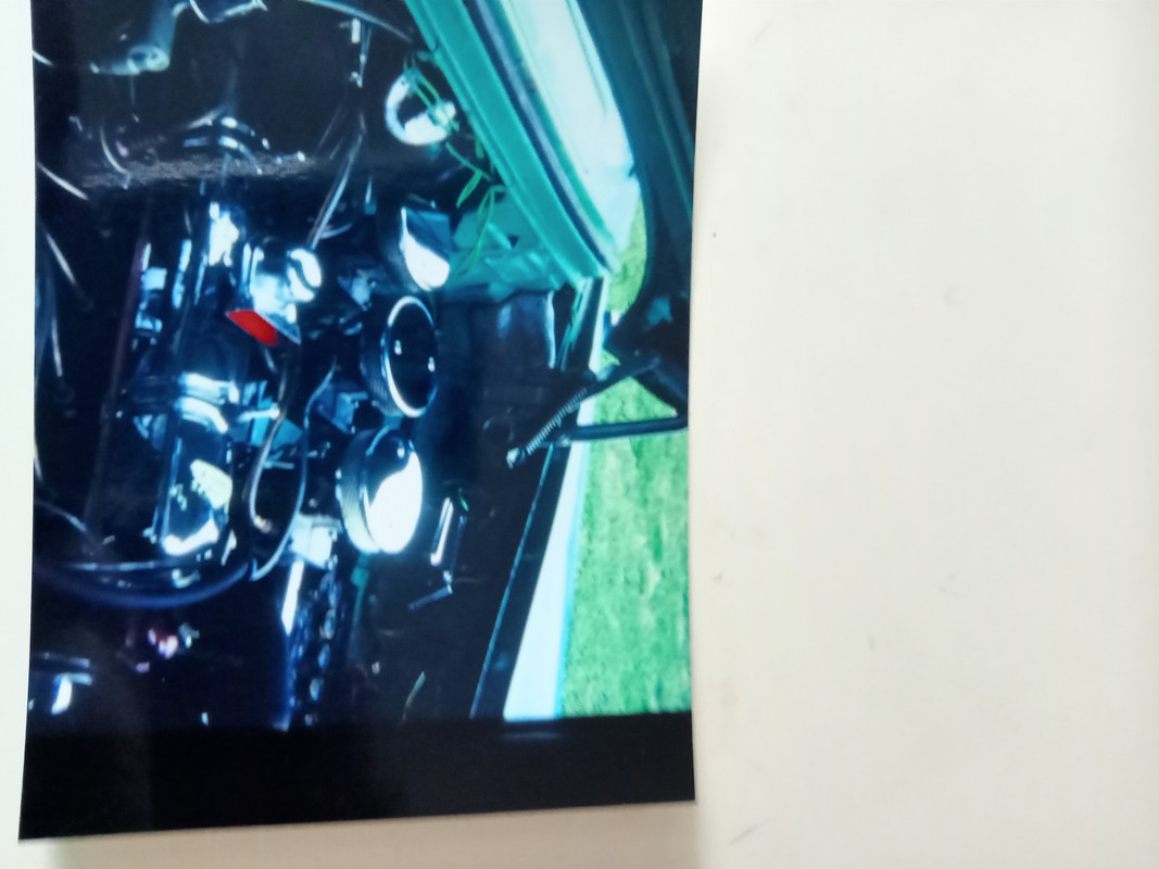

this is motor in FC i ran 3 strombergs on it
