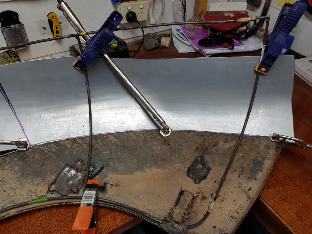

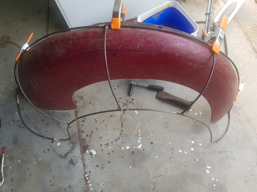

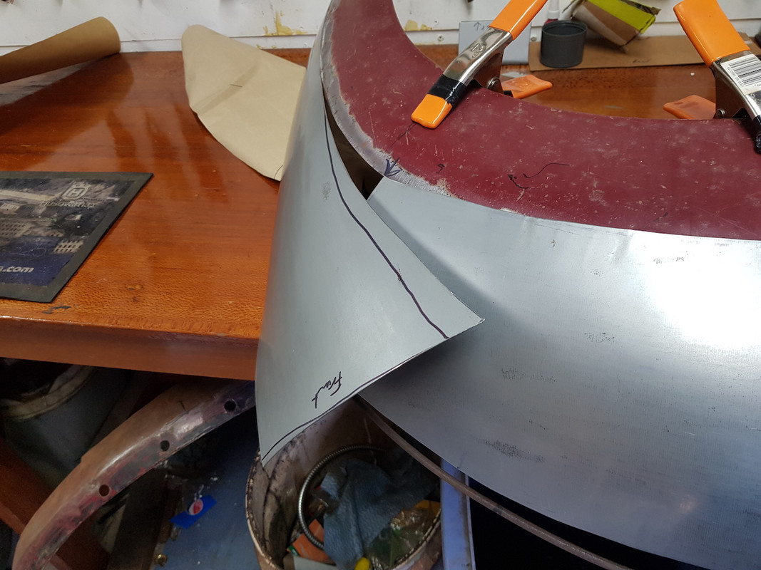

I have also bit the bullet and moved onto widening my rear guards. I first made a wire form using the outline of the original guard that I welded to the car with my wheels on ( but forget to photograph). When I was happy with the shape and clearances I cut it off and laid the original guard against it to get the best position to make the cut. It can be a challenge to make that first cut but it had to be done.

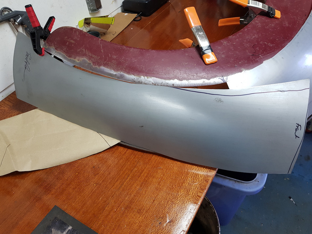

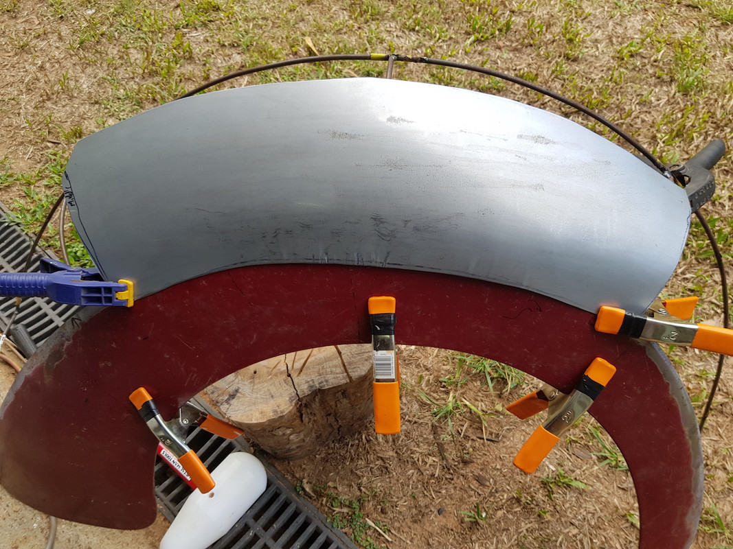

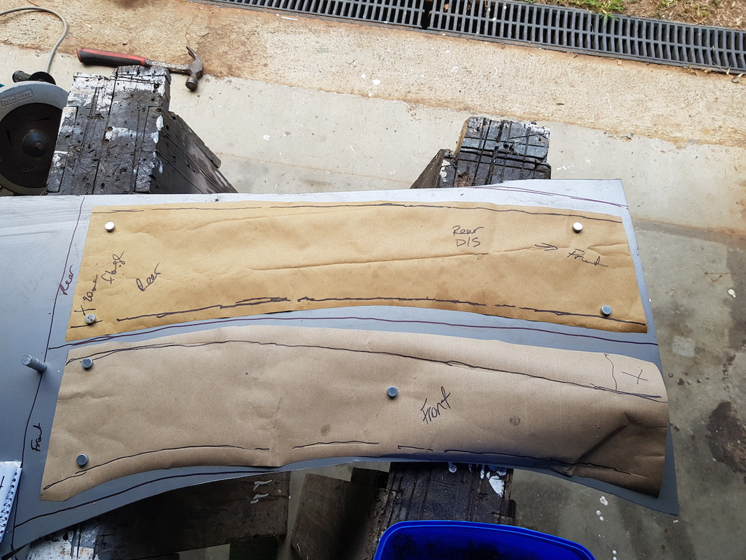

After making some templates I worked out that it might be easier to make the strip in 3 pieces so I cut them out and started wheeling. It was necessary to shrink one edge so after years of watching Youtube I made a shrinking stump, with a random log I had in the yard, and began beating on the perfect panel I had just spent a couple of hours forming
So far all good and the lumps have even come out so there is hope I can make it all out of steel and looking half decent. The best part is you can wheel at night without upsetting the wife or neighbours, so I feel like I am sneaking a few extra hours every week

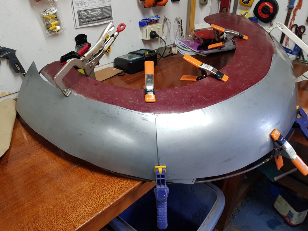

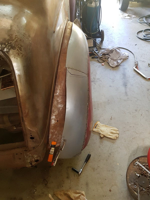

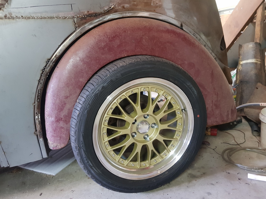

Thanks for the encouragement everyone and I have managed to spend a few hours on the rear guards and am happy with my progress given that I have never tackled anything this complex before.
Then a quick reminder of what I started with-
There is a few flat spots that will ned some shaping but I am hoping to get it all tacked together next weekend and I can start smoothing the shape. I have to say though it is working out ok so far
